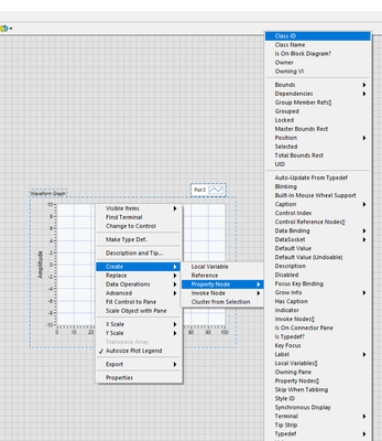

Lately I am disappointed that I face bugs in LabVIEW nearly on a daily basis. I run the latest LabVIEW version. Is NI even testing their products?Please tell me that it is a feature and not another bug that I can't find the property Increment X-Axis->Range-Increment by the Browse function.
What I don't find intuitively is that I have no Browse Button when following: Front Panel->Waveform Graph->right-click->Create->Property , but I having one when right clicking a property node on the block diagram.

I don't know about the Browse button being missing from the Create menu, I never thought to look for it there.
However, the reason you're not finding "Increment" in the search is that you're searching the WaveformGraph class when the property is actually part of the GraphScale class.  If you had a property node that was assigned to the GraphScale class, you would see it on a Browse search.
WaveformGraph contains two hard-linked GraphScale class references so it would make sense if you could find it on the search, but I think that they have to un-include all reference links in those searches to avoid making the Browse list incredibly long.
