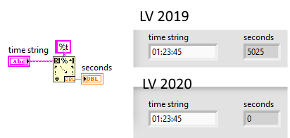

In LV2019, Scan from string can be set to "%t" and scan a relative time string of e.g. 12:34:56, but in LV2020, that doesn't work:
Try attached VI in LV2020 vs an earlier LV version and see.
Or am I missing something?

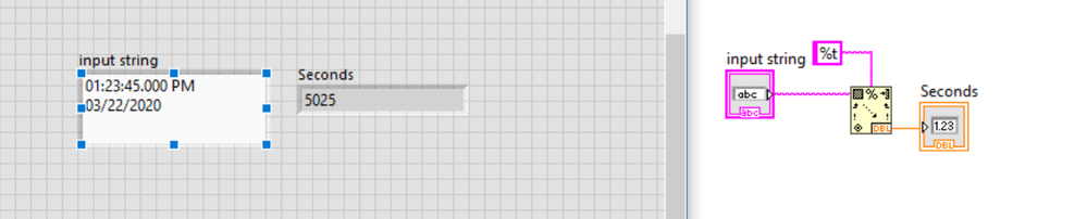

It actually work.
You have to follow the correct format for the input string below in order to get your output:
I'm using LV 2020 too.

Sure, but can you figure out why the string "12:34:56" works in 2019 but not 2020?

 I think LabVIEW 2020 had updated some features and emphasised on the complete writing format for the format ' %t ' which must included the date.
(2,299 Views)
