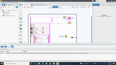

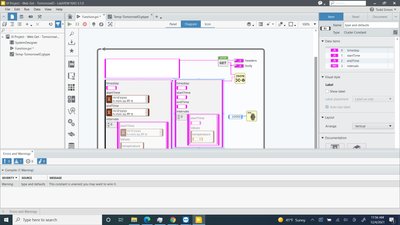

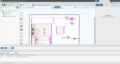

Hello, ran into a weird paradox trying to parse a JSON string from a web request.  I'm trying to specify the LV structure to parse the JSON data into and part of that structure is a cluster, but when I connect that to the Unflatten from JSON, I get a broken wire for datatype mismatch saying the terminal is a cluster of 0 elements.  Of course when I try to pass in a cluster of zero elements I get an error on the cluster constant saying Empty clusters are not supported which makes sense to me as I'm not sure what use that would be.
I'll confess this is my first NXG project so maybe I'm missing something obvious here, but I'm a long time user of LabVIEW and think there is something fundamentally wrong here.  Thanks in advance for any feedback you can offer.

My guess (I cannot check) is that timestamps are not allowed in the target data type. If this is correct, I'm excited to see that the error message made it over to NXG.
Message 2 of 10
(6,767 Views)
Excellent suggestion!  You are on the money, in hindsight I can see how a timestamp is harder to parse and needs more information then strings and numerics. Ironically, when I was testing the cluster by itself the first thing I dropped in was a timestamp and that broke it.
Thank you for your help; pity the error description wasn't more explicit, but life goes on.
