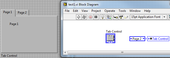

I would like to insert SubVI with Tab Control into SubPanel, something like this:
When SubVI executed, then I will set it to Page 2:

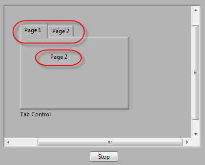

Now what I've got in my SubPanel:
Page 2 is active, but selector is not actualized - still show me active Page 1. Fully inconsistent.

You're right - there are many ways to workaround about this bug. For example, if I will use Property Node instead of terminal or local variable, then it will working properly.

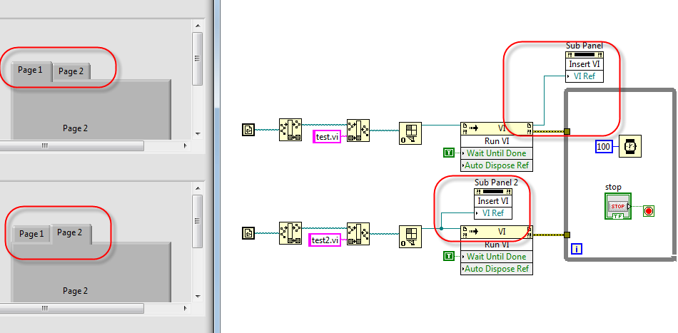

Hmmm, I was able to reproduce it from scratch in 2013SP1. It looks like race condition, or so, because it important where you  connected to the reference.
Compare:
