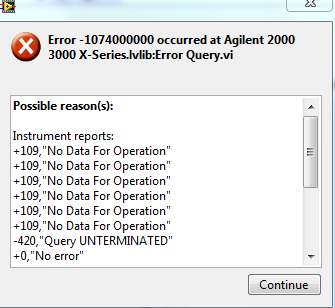

There have been a few forum threads discussing a problem while attempting to extract an averaged waveform from a variety of Agilent scopes using the agx2k3k driver. The symptoms of the bug are that upon trying to read the waveform, the "Fetch Waveform" VI is called (either explicitly or from a higher level VI) and the scope responds first with the error "No data for operation", and then "Query unterminated".
The cause of the error is that the "Fetch Waveform" VI always requests a RAW data record (":WAV:POIN:MODE RAW"), regardless of the acquisition mode selected. This is an invalid request, as the Infiniivision X-Series programmer's guide explicitly says that if using RAW or MAX data retrieval that: ":ACQuire:TYPE must be set to NORMal or HRESolution.". Another problem with the driver is that the specified data encoding ":WAV:BYT LSBF;:WAV:FORM BYTE;" is only 8-bit, which causes a loss of resolution from the possible 16-bit data in either averaging or high resolution modes. Also the LSBF option should be changed to MSBF to ease conversion into a Labview-type waveform.

Thanks for your response. It looks like you added the Input Impedance option to the Configure Channel VI. You set it to 50 Ohms. If I run in averaging mode, I get the -220,"Parameter error" and  +0,"No error" errors
If I switch the input impedance to 1 MOhm (which is the default), I still have an erorr which looks like:
Also, if I leave it at 50 Ohms, I get the same -220 error when trying to run in Normal mode..
My scope is the DSO-X-2004A, so it is different than yours. I've added another block to the code that configures the channel to include the bandwidth limit 20 MOhms, which is something I need for my application.
Still having trouble though.
