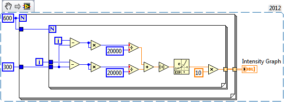

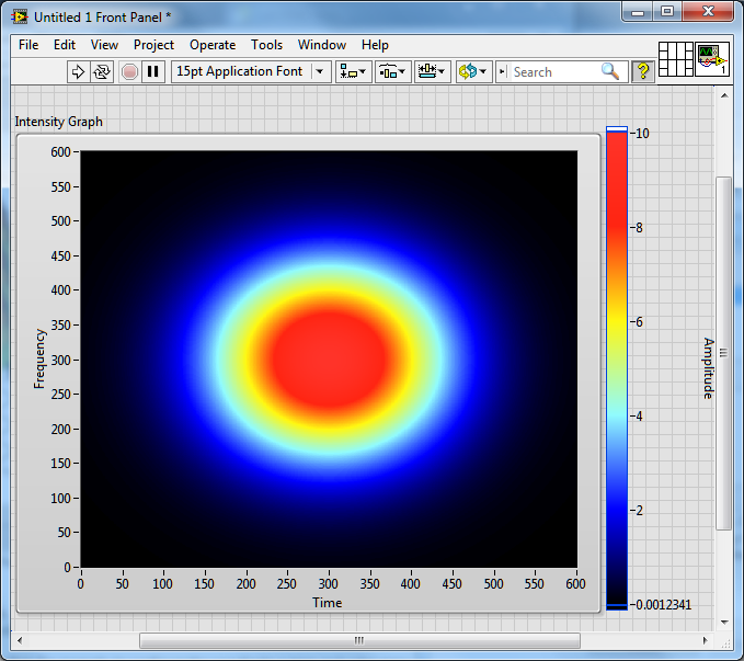

You would run your x and y values through the 2D Gaussian function but making the origin 300,300 (for your given 600x600 pixel array). Here's what I get on an intensity chart given an amplitude of 10 and sigma = 100 pixels:
Here's the example (quick and dirty) code:

Just change the amplitude on the output of the exponential to 255 (instead of the 10 in my code example) and then convert to U8. Like this (after changing the marker colors in the intensity chart):

You used the wrong exponential...Use "exp(x)" instead of "exp(x) - 1".
