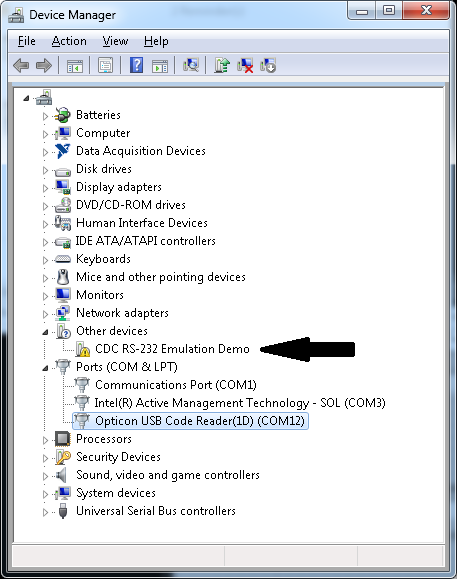

The following image is how my device looks before installing INF files:

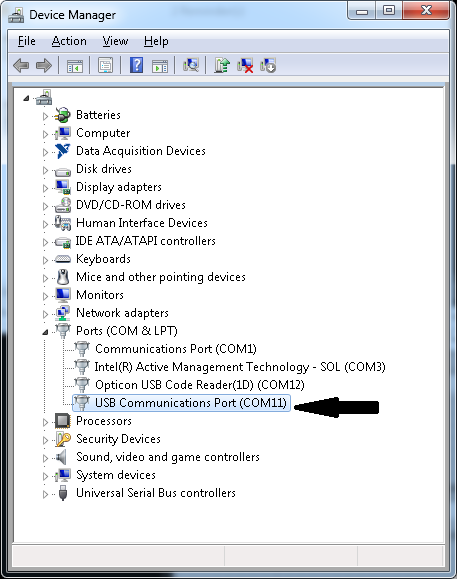

The following image is how my device looks after manually installing the INF files:
