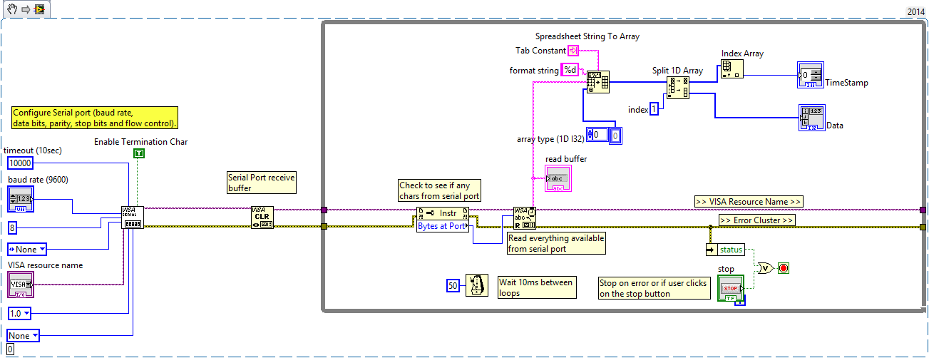

Glad to hear it is working better for you now.
But still get rid of the Bytes at Port node.  Just put a very large number in there for bytes to read.
Why?  Suppose the way things go in timing that it gets the number of bytes at port, but the whole message hasn't quite come in yet and you haven't got all the way to the linefeed.  You are expecting 123456789\n, but when the bytes at port executes, you've only gotten 123456,  and the 789\n hasn't quite gotten there yet.  Bytes at port will be 6.  You'll get 6 bytes "123456", and the 789\n is going to sit in the buffer until the next time around.  Put in a bigt number like 100 bytes to read (whatever is more than the longest message you expect to receive) and the VISA read will sit there waiting for the \n to come in.
One of the things I hate most about the LabVIEW serial port examples is that they all show the bytes at port node being used.  For about 99% of the serial port communication systems you'll see, it is the wrong thing to use and you should not use it.

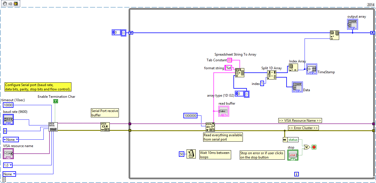

Your explanation makes perfect sense.  Thanks Again,
My code now looks like
1 million may not be a "large number", but it seems to be working, and I will keep an eye on it as the code progresses.
I really need to expand my understanding of how the LabVIEW serial and VISA functions work.
Austin.
Message 13 of 18
(3,829 Views)
That should work.  And should be more than large enough number of bytesSmiley Happy

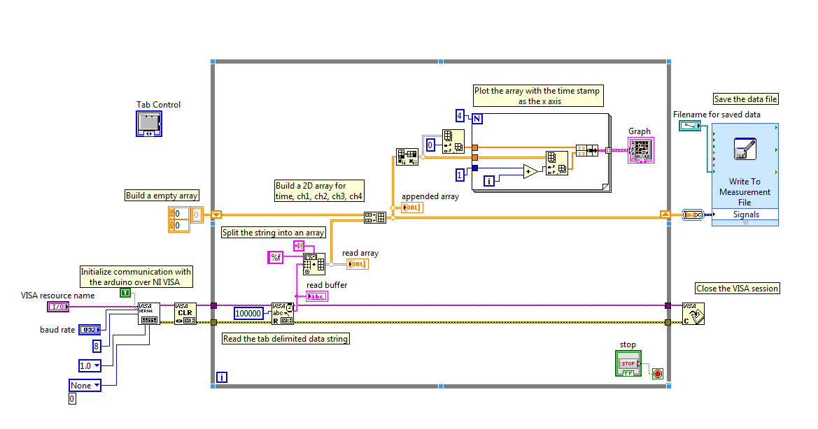

I often come back to this thread when I travel or need to rewrite the code so I thought I would share a cleaner version of the code above.  I have included a picture and an 2013 VI.  I also posted this on my personal website to ease in handing it out to others who need it.
http://adowney2.public.iastate.edu/projects/The_simplest_Arduino_LabView_data_logger/The_simplest_Ar...
