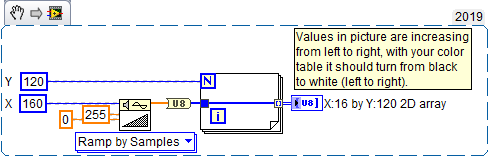

Some more notes:
The "reshape array" function is very fast, so there is no performance issue at this point.
Place a probe at the array wire where the received values are stored and see whether the expected values are there.
To check the picture function, you could do something like this:
Greets, Dave
