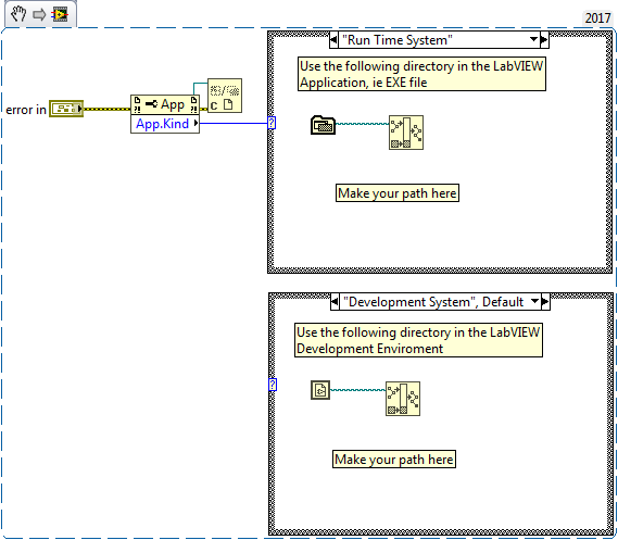

The application directory is the right call, however I would like to recommended the following modification, that way you can switch from development environment to application environment without worries.
Both Cases ShownBoth Cases Shown

McDuff, part of the point of the Application Directory is that you do not need to mess with the App.kind.  As already stated, just make sure your support files have the same relative path to the project file as your executable.

Got it, thanks.
Sometimes though I do not always use the same relative path, not sure why, I guess that is sloppiness on my part. (The support directory in the EXE always default to the ...\myapp\data, did not know that could be changed.)
