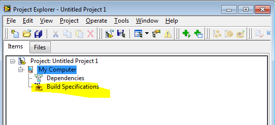

Are you in a LabVIEW project or in Windows explorer?
(6,295 Views)
I am in Windows Explorer.  I cannot find a "My Computer" option in any of the menus of LabVIEW.  Where is it?
(6,233 Views)
You need to open the project explorer in LabVIEW.
(6,222 Views)
Thank you. You may have to walk me me through this like I'm a 4th grader because apparently I'm not getting it right.  I went to File>Open and this is the dialog box that came up.  The Project Explorer did not come up, as the LabView help said that it would when I went to File>Open.  How do I bring up the Project Explorer?
(6,210 Views)
Accepted by topic author matt_physics
The LabVIEW help is assuming that you are in the LabVIEW Development Environment, so you need to open LabVIEW first and then follow the directions.  But it might be worth your time to go through some of the free training.
