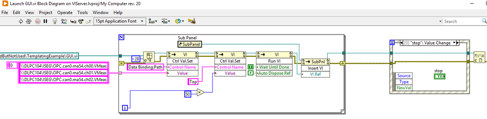

I try to build a database-driven application, where UI elements/controls on front panels are populated dynamically based on data from database queries. I would NOT like to build UIs at design time which have all possible controls pre-defined and are shown/hidden dynamically. I am currently experimenting with subVIs placed at runtime in a sub-panel. Where the code works expected if I only place one subVI-instance in the sub-panel, I am not successful with placing multiple instances of one subVI in one sub-panel. Note: I would NOT like to have hard-coded sub-panels for each instance of the subVI. How do I do this? Is this possible at all?
Currently my code looks like this:
 The code works in a sense that the subVI is placed three times in the sub-panel, each instance below the other. However, the instance created in the previous loop becomes invisible or is destroyed as soon as a new instance is placed in the subVI.

A single subpanel can only contain a single VI's front panel. What you can do is place multiple subpanels into a another subpanel and load each of those with the instance you would like to display. Or, you can simply add some control which will allow you to switch between the instances and you swap them out to display the user desired instance.
I highly recommend that you look at MGI's Panel Manager package. It greatly simplifies your panel management.

Yeah, I feared this. Quite frustrating dynamic VIs with LabVIEW...

+1 for the MGI Panel Manager. I use it for everything. It took me a couple hours for it to "click" but once it did, boy is it useful.
Keep track of the VI references you create with Open VI Reference, then you can call Insert VI Ref into the subpanel on each one. You could do this with a scrollbar to make it look like an array of subpanels, or a list to the side with names, then when the user clicks an item in the listbox that element is inserted into the subpanel. MGI's toolkit will help a little with the abstraction but it's pretty simple at its core, you just call Insert VI Ref on the VI Ref you want to see and it'll show.
And yes- subpanels can only contain one VI at a time. That's why your method isn't quite working.

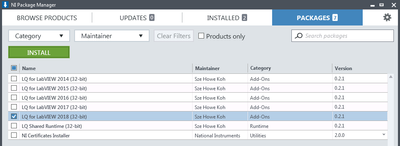

The LQ packages include Qt and Qwt under open-source licenses which can be used in a proprietary LabVIEW project. So you don't need to get Qt separately; just install it via NIPM (see https://jksh.github.io/LQ-Bindings/docs/ for a walkthrough)
nipm-packages-install-lq
Note: Qt is a huge toolkit and I've only exposed a small subset through the LabVIEW API so far. If you'd like to try out features which aren't available yet, let me know and I can make the relevant updates.
