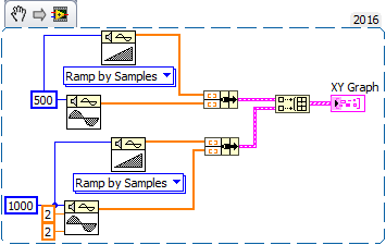

Use multiplot XY with array with 1 or more elements.
you can add/remove array elements any time

Look at the shipped example on how to display plots in an XY-graph.
Store the 'old' plots as array(s) in a shift register
from your last plot x values, lookup the max and min value (min/max array) and use the x-scale-range-min/max properties to change the scale shown.

ok.... I cannot seem to make my XY graph become a multi plot... just getting a broken wire when I try to connect wire to plot... sorry for the dumb question but do I get a multi plot XY graph
(3,685 Views)
no bother... realised I had to delete the old xy graph and add a next one for it to accept the change!!! why can't labview just update that automatically.... I ask myself!
(3,683 Views)
Labview can.
Maybe you tried connect local variable or terminal to array when another copy was connected to scalar?
