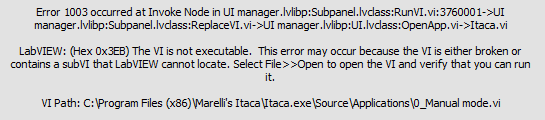

I'm using Labview 2018 on Windows 10. I have an application which doesn't have any dependencies other than some DLLs, which are included with the application. I'm building an executable (which includes those DLLs), in the same folder as the source code and it runs fine. I'm building an installer and use it to install the application in program files (x86) and it gives me the following error:
If I copy the executable, from the folder with the source code over the installation in program files (x86), I get the same error. If I copy the installation from program files (x86) over the executable in the folder with the source code, it works perfectly.

Right, I managed to make a bit of progress here. My code also depends on a lot of functionality which I have in separate compiled labview libraries (.lvlibp). These libraries are all included with the executable.
One of these functionalities is an XControl placed in the VI to which the error refers, which is dynamically called. I managed to partly debug the executable and figure out that the probelm is that the XControl cannot be loaded when the executable is in Program files (x86). If a replace the XControl with a regular control, everything runs fine.
Now the problem is why can it not load the XControl when the executable is located in Program files (x86)?

I managed solve the problem. I found a similar issue in another forum post which described that Labview has a bug. This is what happens:
When you have an XControl in a library (mine was in a .lvlibp) and this xcontrol is used by a VI (which is outside of the library) and you build everything in an executable, Labview doesn't load the library with the xcontrol correctly. So the VI sees the xcontrol as broken.
The solution is to ensure that the xcontrol library is loaded before the VI which contains the xcontrol needs to run. This can be done by placing a static VI reference to the xcontrol Facade.vi, on the block diagram of any VI which is loaded into memory before the VI which contains the xcontrol.
