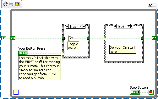

This might help

Ah, so may something like this work?
And what has to be under false when the loops are false? I just connected them straight through so it didn't show an error.
This basically is "supposed" to set the output to a single motor only when the switch is on.

That is the basic idea. The false case would simply wire the value through.

Ah, FIRST.  In my experience, with code akin to that you are going to see multiple flips since the loop will likely iterate more than once per press.  If I recall correctly there is some code in one of the Examples in Example Finder to help mitigate this problem using an XOR

Although, I'm having a major issue with this. I know it's basic, but what else could be done to make it work?
Any time this is included in the programming when dumped to the robot; the robot wont drive and the camera won't work.
Although, without that snippet of code, everything will work fine. I've done this multiple times and confirmed that it's this code that's doing it.
Is something misplaced somewhere? I added a Close to the right of the outer loop and that did nothing. It seems like the code is overwriting everything else and only letting that be processed.
Any ideas on how to fix this?
