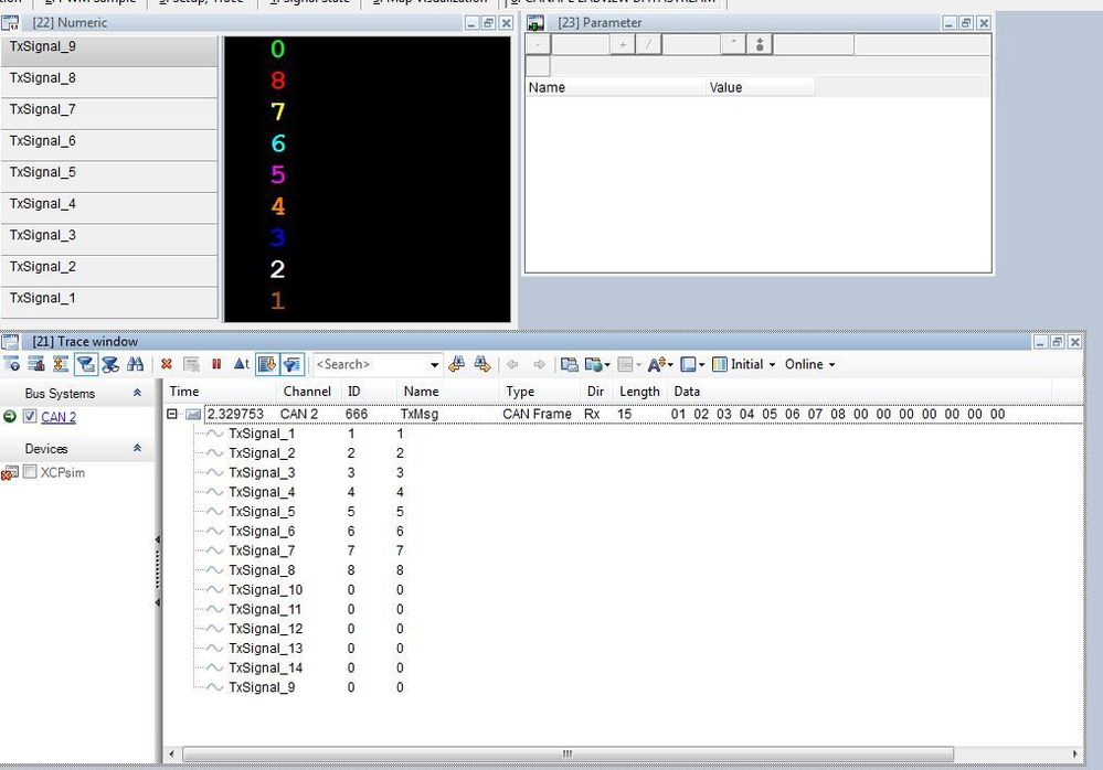

Hi, I have been trying to transmit CanFD data from LabVIEW to CANape on the same computer via virtual CAN. I used your code and I am half way there.
I am only able to send 8 bytes of data. I have set the tag to x440 and the msg_flag to 0(I believe this is for extended CAN, other numbers don't work mostly).
Have a look at my VI. I wish to send more than 8 bytes and read it in CANape. I configured a dbc file with standard CAN FD message with few signals for testing
AS you can see from the canape screenshot, the length remains 15 and if i change the dlc to 12, 12 bytes of data is transmitted, however only 8 contain the values.

Please make sure you understand how the EDL and BRS flags work in a CAN-FD frame and when they need to be set. Also make sure you understand how to set those flags in the msgFlags parameter of transmit message.
The answer is in my response which has been marked as the solution in this thread (immediately above your question).
