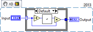

I'm not talking about iterative recursion ("fake" recursion). That has always been an option, but can result in more complex vs. more complex concept. I usually prefer recursive VI's as well.
I was saying the dynamic call by reference can be replaced with a call to the same VI:

@Wiebe -- I completely mis-interpreted your remark ("OBSOLETE").  I was thinking "recursion" (= reentrant VI) and didn't realize I hadn't mentioned the word earlier, and thought that you were saying that the recursive method was obsolete!
This may be due to a similar post around the same time asking about Fibonacci Numbers, which also have a Recursive Definition, and I had "recursion" on the brain (or what passes for a brain).  I completely agree with your FactorX method of computing X!, though I might have made the Default case return "1" and the other case be 1.. (to foil being called with negative numbers).

That happens. It was clear to me it was just miscommunication. Just made the example so others can learn. We really don't want people to take those exam questions as an example.
The default and 1.. cases makes good sense.
Didn't think the factor vi through, I did not even run it before posting! Just remade the VI from the image.
