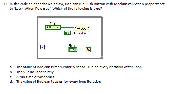

Here is Q34 from the CLD-R practice exam:
The answer sheet says that answer 'c' is correct. However, I've just tested that code and it runs indefinitely until I hit stop, so I would say that answer 'b' is correct.
Which answer is correct? If it is 'c', why do I not observe the expected result of a run time error?

There is a run time error coming from the property node. But you have to enable automatic error handling to see it (but please don't).
The property gives an error since latched Boolean controls can't be set by a local (edit time error) or property (run time error).
The VI does not run indefinitely, as is stops when you press the button.
So, definitely C, AFAIC.

Ah of course, and now I think about it I've had that exact problem before! Silly me.
Regarding the run indefinitely, my interpretation of that was the VI would run indefinitely until the Stop button was pressed as the property node was having no effect on stopping the loop. I agree the answer is C though Smiley Happy
