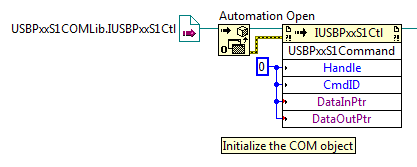

I have some documentations and C++ example which are attached here.  Page 72 of the pdf file talks about USBPxxS1COM programming and the 4 steps for initializing the COM object.  Also, "TestClientDialog.h" file in the example explains in details how this is done...
Can you please check one thing in particular for me: The 4 necessary steps to control this ActiveX/COM object.  Do I take these steps by the following code:

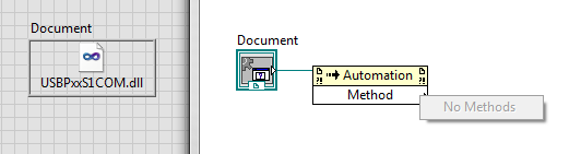

I had tried ActiveX Container before, but no luck.  Here’s what I do:
1. Insert ActiveX Container in the Front Panel.
2. Right click on the container and select Insert ActiveX Object.
3. I’m supposed to select the object from the list, but it’s not available!  So, from the top of the window, I select Create Object From File, and I browse and select “USBPxxS1COM.dll”.
Here’s what I get on front panel and block diagram, and when I put property node, invoke node, or register event callback, there’s nothing to work with.

Yes, both the Handle=0 and the CmdID=0, then once you get the handle it looks like, you need to initialize again, per page 13-12 of the manual section 13.4.1.2.1

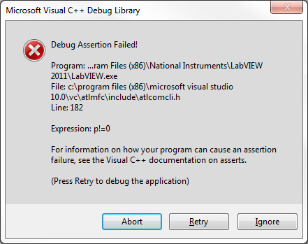

I also tried to encapsulate their example in a DLL and use the Call Library Function Node, but I get this error (just in LabVIEW not in VC++).  I'm not sure if LabVIEW is compatible with ATL.
