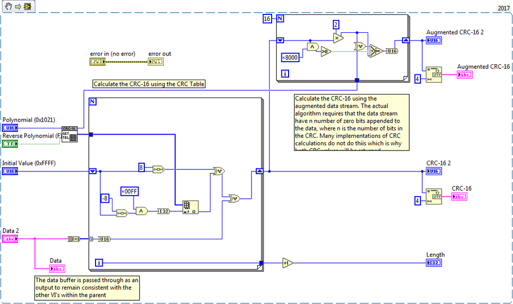

With regards to the .vi file you attached I cant seem to find a table of values anywhere, the function I have pulls values from a given table. So i am unable to see how this would work in my case.
Also I have created a .dll file and created my program using that, I have attached a picture with what I have currently in LV, to allow you too see what I see. I have also attached a copy of the header file used (checksum.h), and a copy of the code used for the CRC (checksum.c).

This is what I'm working with... (see attached)

Okay, so your function uses a lookup table and the one I supplied does not.
I still do not see the issue, unless there is something about your function you are not telling us.
