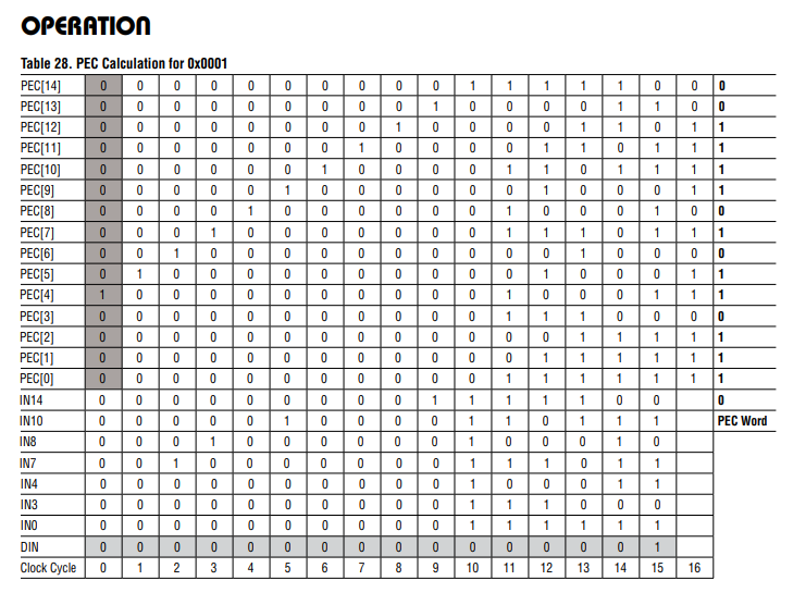

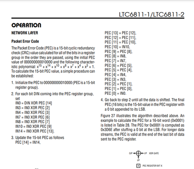

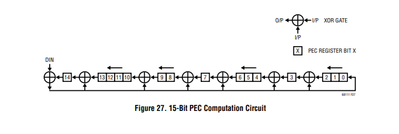

Just to check if anyone did do a CRC15 VI calculation before using LabVIEW? Have been searching through the forums but didn't find any. I am currently tasked to develop a VI to calculate the Packet Error Code for the LTC6811 Chipset developed by Linear Technologies but I realize the Packet Error Code (PEC) is the same as the CAN bus for the first 15 bits, the only difference is the last bit which there is a 0 attached for the Final PEC. I have attached screenshots obtained from the datasheet below

I have tried it out with a design of my own version of the VI, and have attached it in the reply. I am currently having issues getting the correct output for the PEC. For example, the PEC of 0x0001 (input DIN) will be computed as 0x3D6E as the final result, but I am getting otherwise.
