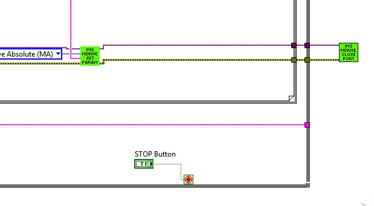

@MPCARTIST wrote:
Doing that.
Removing the frame, that works.
Moving the close port brakes it.
Breaks
Disable the autoindexing tunnels!

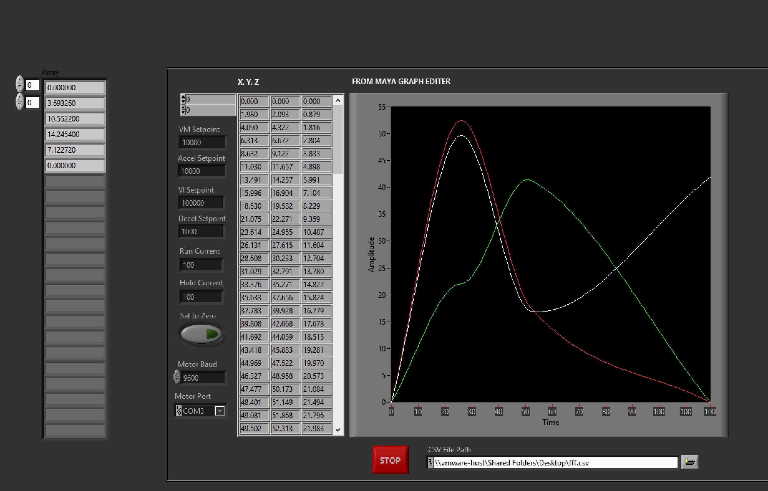

The VI did read the file, convert it and it controlled the motor. Straight lines work very well, but I do have a problem with curved splines, the motor judders. All my lines are curved.
Is there a way to smooth it out. This must be possible for other sliders to work. Like DittoGear.

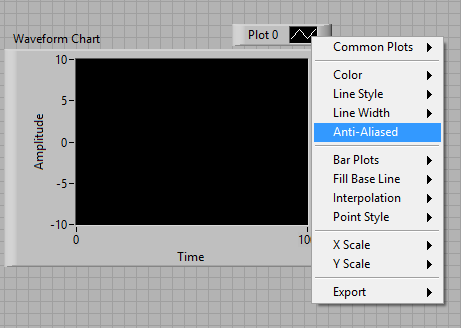

1. R-click graph -> Visible items: Plor Legend
2. R-click each plot (it's expandable) -> Tick Anti-aliased
3. Profit. 😉

This is fantastic!
I just sent a post out asking for help on this.
I just did what you suggested and I will test later when I'm on the machine.
That is great!
