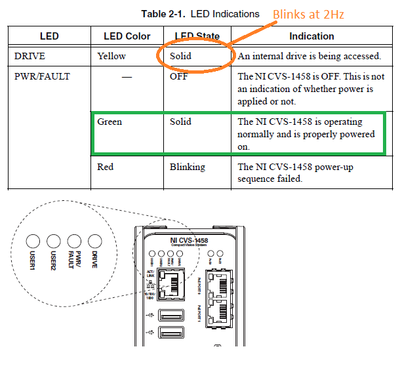

Attempt to boot into bios holding the Delete key (as the bios update manual says) shows no activity on the VGA port nor the USB bus. The indicators are as shown in the figure below. Drive starts yellow for 30sec then blinks at 2Hz.
