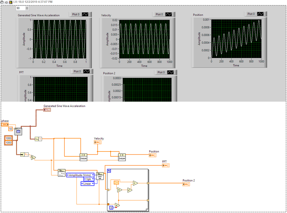

So here is my implementation to calculate in the frequency domain.
How do I get this data back to the time domain?

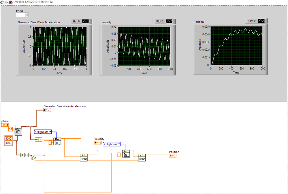

This is what I get when I implement a high pass filter.
Dan Shangraw, P.E.
Message 14 of 18
(4,026 Views)
I keep starting replies but don't get a chance to finish before the thread has moved on without me.
The highpass problem you're seeing is the transient response of the filter.  It's not generally avoidable.  I don't recall all the math, but I'd venture that the transient for a 1 Hz highpass is pretty well gone after 4 or 5 seconds.   Try generating 10 seconds worth of sine wave, but only display the last 5 seconds worth of the Vel and Pos integration results, after the filter transient has faded away.

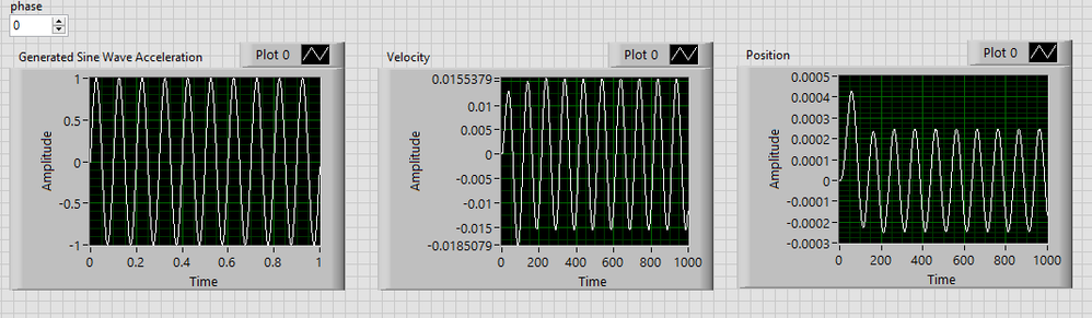

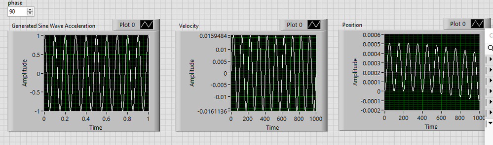

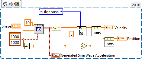

Here's a quick implementation.  There is something wrong with your code, see below.
Your signal is clean so I didn't implement a second high pass, which you can do.

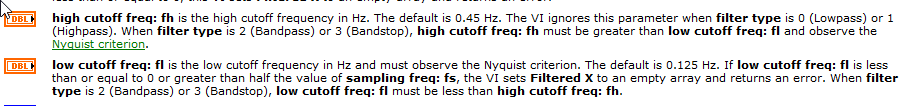

Most Important. Your high pass filter is wired incorrectly. Wire the the stop band to the low frequency cut-off. Look at the help.
mcduff
PS You will see that phase does not matter here, I set it to 0.
Edit: Showed the wrong picture for 0 phase, below is zero phase.

Thanks the reminder.  I missed you need to wire the High Pass cutoff into the Low Pass cutoff frequency when high pass filter is selected.  Very intuitive 🙄
