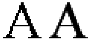

Take the following image on the left. You can see it is quite jagged.
Since pixels are square/rectangular you cannot have a perfectly straight edge on a line that is not horizontal or vertical.
But looking at how the edge of the object actually is, the jaggedness can be "smoothed out" and hence help determine what the perimiter should be were it perfectly smooth.
