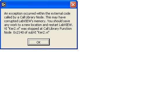

The problem is the results: an error message or LabVIEW crashes. I use LabVIEW 6.1 and I can't see the example by Aaron on ni.com (buid in 8.6). I try to use reference insted val by the problem persist. It seems to be a memory allocation problem, but how can I solve?

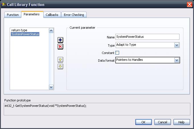

What does your function prototype look like? It should be setup as a  stdcall (WINAPI) and look like this within the call library setup: int32_t GetSystemPowerStatus(void *SystemPowerStatus);
Here is a screenshot of the function parameters as well:
Hopefully this will help determine where the problem is occurring. We need to make sure that all the parameters are the same between this example and your code.
-Zach

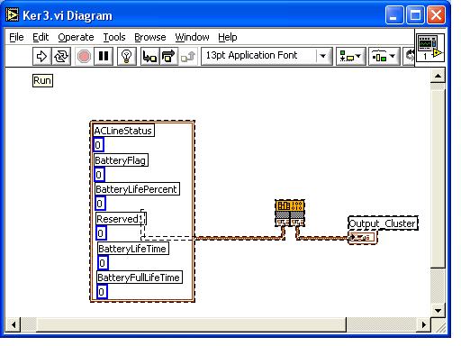

I was able to track down an older version and saved the example in 6.1. Here it is.
-Zach

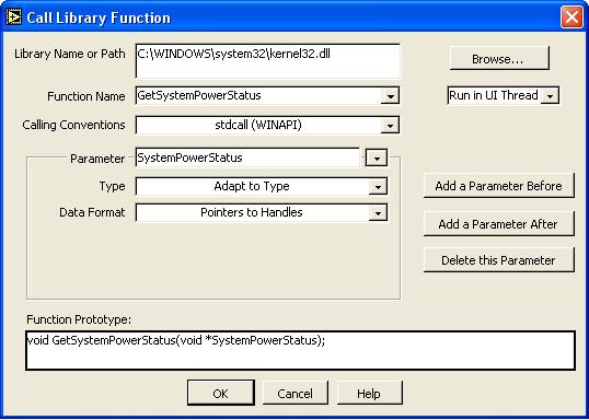

Hi! Zach, thank you for your reply. Now works fine. The problem was to the Name: I put name "Cluster" insted of "SystemPowerStatus". This is the onl;y difference. Of course in prototype I have  "void" instead "int32_t", but works fine.
Thank you to help me to solve this problem. I'll use this program to control a relay, to connect and disconnect power supply to a laptop. Thus, charge/discharge cycle is complete and battery life is longer.

This makes no sense! The Parameter name is just cosmetics. It has no influence whatsover on how the DLL function is called. So there must have been another change.
Rolf Kalbermatter
