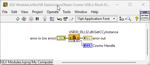

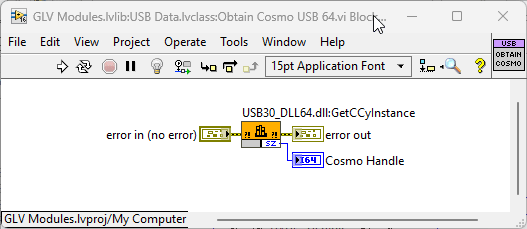

My understanding is that I can specify the name as "C:\My Folder\USB30_DLL*.dll" and the * will automatically change to 32 or 64 based on the bitness of my LabVIEW. When I change the 32-bit path to the wildcard it seems to work fine. But when I change the 64-bit path to the wildcard it breaks the VI and says the library cannot be found.
32-bit: no problem
64-bit: breaks the VI

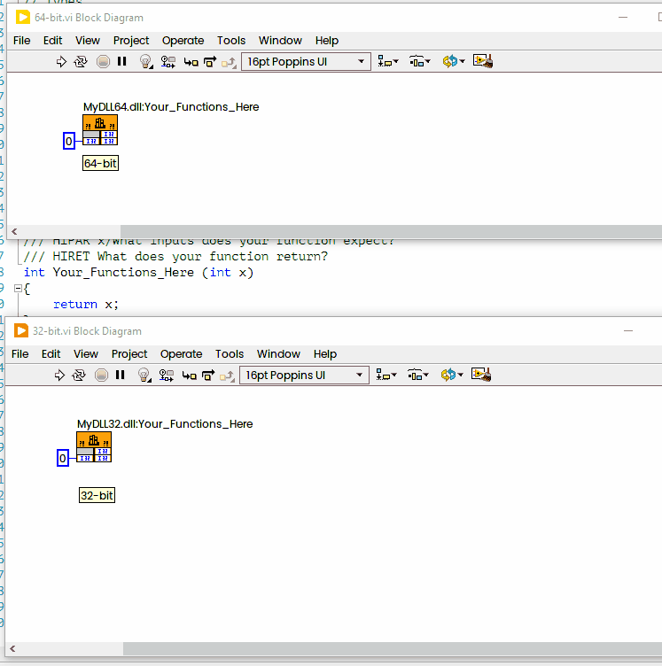

Quickly checked with LV2024 and was unable to reproduce:

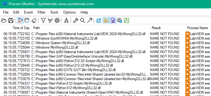

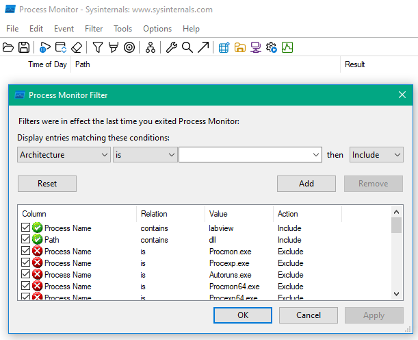

Well, one trick which I using often to troubleshoot "Broken by not found" issues is Process Monitor from SysInternals.
Download it and on first run setup two filters to get events from LabVIEW only in attempt to open dll:

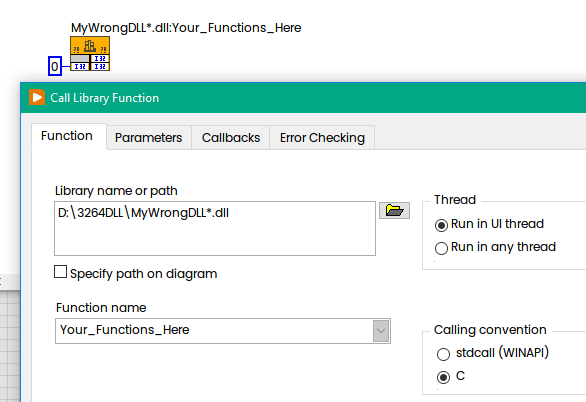

Now when something gets wrong (i can "provocate" this by entering wrong name):
then Process Monitor will show all attempts which file will be opened and where exactly:
May be you saved somewhere 64-bit DLL under *32.dll name and this occasionally loaded (just idea).
And not only DLLs, but other missing files like ini etc can be catched by this approach.

Hi Andrey,

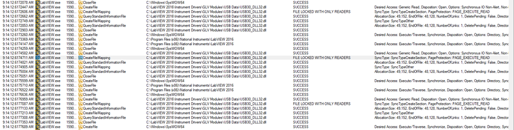

Thank you for the tip on Process Monitor. I was able to get the broken run arrow again, and when I looked at Process Monitor there is an operation with the DLL path that says FILE LOCKED WITH ONLY READERS.
Process Name: LabVIEW.exe
Operation: CreateFileMapping
Path: "...USB30_DLL32.dll" (this is the path I expect)
Result: FILE LOCKED WITH ONLY READERS
