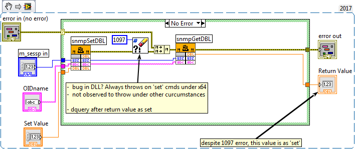

I have a dll that appears to work fine except for the error 1097's it throws for certain functions.  The DLL enables get/set command on a piece of hardware.  The 'set' commands throw this error.  Despite the error the CLN appears to correctly 'set' the function, so I'm not sure what is going wrong.  I don't see any evidence of corrupted memory as a result of the error.
-It isn't the calling convention
-The CLN is correctly configured to match the header near as I can tell.
     -(however I'll not one thing I found confusing. If the CLN is set such that the parameter that should be a pointer sized value (according to the header) is set to a 32 bit value, the CLN complete equally well. This is surprising)
A snippet and the relevant header follow. I did not write or compile the library code, I received the compiled dll from the vendor.  (I cannot confirm therefore that the dll was compiled form the source below, though the vendor says that it is)

Could you do a save for previous and save it as 2016 or earlier? From the pic alone it doesn't seem like there would be something wrong.

There is a chance that the DLL is actually doing something bad and causing an exception either in the called function itself or in one of the functions it calls. If this exception is not caught in the DLL itself, LabVIEW will catch it and translate it to the 1097 error. So definitely something to discuss with the vendor of this DLL.
Also there is no chance to have the wrong calling convention in 64-bit LabVIEW as it only supports the default calling convention which is __fastcall.

I did not expect it to work in LabVIEW 2016 at all. The reason that I asked you to backsafe it is that I currently only have LabVIEW 2016 installed on my work machine, and checking Call Library Nodes from a picture is very much not helpful. To much information in the Call Library Node configuration is simply not visible in the picture.

So I checked the VI and compared it to the header file declaration and I can't find a reason why the code should cause a 1097 error. Now LabVIEW doesn't create such errors randomly so something is going wrong inside that function.
And here you really have to start debugging on source code level in the C code. I'm pretty certain that the error gets visible pretty soon then. It could be an exception or it could be a buffer overflow somehow.
You can also try to increase the debugging level in the Call Library Node to maximum. That might give extra pointers as to the problem. Ignoring the 1097 is NEVER a solution if you don't know EXACTLY why it is happening. Something happened that could have pretty grave consequences at some point after you start to modify seemingly unrelated parts in your application that change the actual memory layout of the structures in memory in such a way that a now critical data pointer is at the location the DLL is corrupting and that could make itself only apparent after you installed the application in your end system. So never ever ignore errrors that you do not absolutely fully understand!
