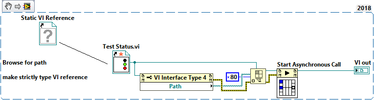

I've had my issues with vi server in an exe. Usually 3rd-party driver vis where the vi "loses" subvis and various linkages. I find the subvis and include them in the build but they still don't link.
I've had much better luck using static vi reference.
PaulG.
