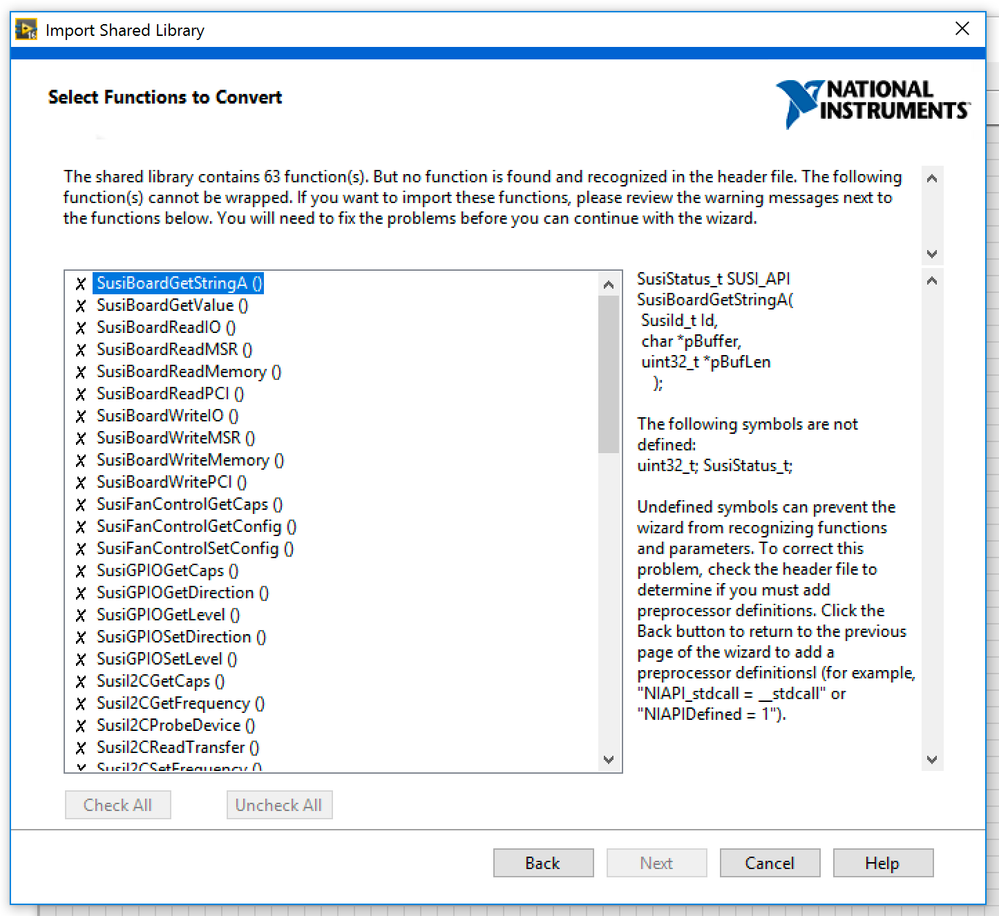

I would actually prefer to use the import shared library wizard so it will wrap all of the functions but I get this.
Message 5 of 13
(5,798 Views)

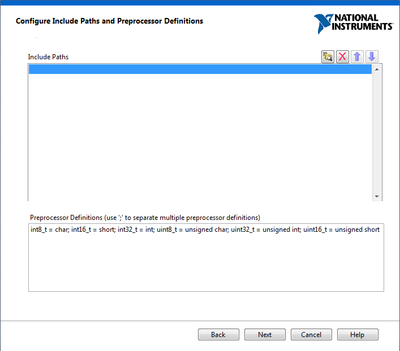

However, it seems you want to use the Import Shared Library Wizard (ISLW) instead to call the DLL. As the errors you generated show, some of the definitions are missing in the header file (I'm assuming Susi4.h is the one you are adding to the ISLW). This is because of the two header files you have, OsDeclarations.h and Susi4.h. In order to get past the functions missing issue you are facing, in the previous window there would be a section to add preprocessor definitions:
Since the definitions required are in the OsDeclarations.h file you would have to add the following in the Preprocessor Definitions:
int8_t = char; int16_t = short; int32_t = int; uint8_t = unsigned char; uint32_t = unsigned int; uint16_t = unsigned short
That should allow you to then use the functions.

Hi Jeneni. Just tried it and it works beautifully. The reason for using the wizard is that it converts all 63 functions into vi.s instead of having to do them one at a time. Fantastic result, thanks a million.
