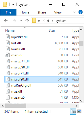

Well, I intended using the VC2k8 runtime, the v90 dll being what I found on the target system.
I don't think you can use VS2010 tk since there is no msvc{r,p}100 DLL on the machine
I did have to install VS2008 in order to simply compile for that toolset in VS2010.

Ok: I finally understand Rolf's post,
Yes: I will install the MSVC2k10 RT on the target and retry with that toolset.
