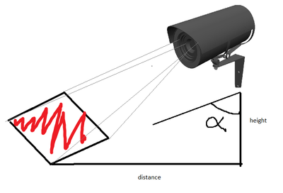

At this moment i am using Perspective Calibration to calibrate my camera in vision assistant. The camera is at a certain height and distance/angle (see figure) removed and it works fine in the testing phase.
But i was wondering if there is an other option or program to calibrate my camera without selecting 4 points  with the real distances.
So i want to calibrate my camera by just giving 2 parameters: height and angle or distance (i prefer angle instead of distance). Is this possible or not?

Camera height+distance/angleCamera height+distance/angle

Unfortunately, this is not possible. The only other way to calibrate the image to take into account the perspective distortion is to take an image of a grid of points, such as the one you can find at this location:
C:\Users\Public\Documents\National Instruments\Vision\Examples\Images\Nonlinear Grid.png.
Then, in the Vision Calibration Training interface (C:\Program Files (x86)\National Instruments\Vision\Utility\Calibration Training Interface\NI Calibration Training.exe), or from the Calibration step in Vision Assistant, choose to create a Distortion Model Calibration.
But the NI Vision Calibration functions don't let you create a perspective calibration by just entering the position on the camera with respect to the imaging plane.

I am afraid not in Vision Development Module. Sorry.
