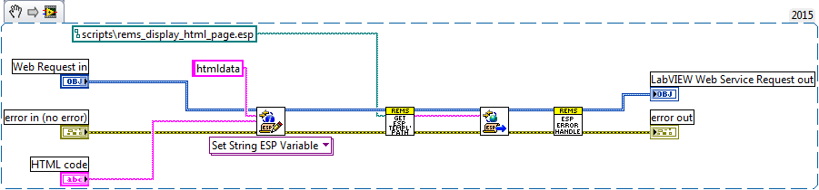

While using esp script seemed to be a nice idea first I ended up not using it for scripting. I have found it very hard to handle and hard to read so my ENTIRE html document (including javascript and everything else, except css) is generated in LV, in which I am very familiar with iterations etc. I still needed to use an esp file to display my generated contents, but I my esp file only had the followings:
var htmldata = form["htmldata"];
write(htmldata);
The code injecting my generated html content to the esp file was as simple as this:

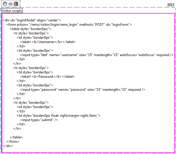

I assume you have some sort of an HTML knowledge, so you will understand whats going on in the following html script which was the part of my main html code. If you dont understand this then you gotta get some HTML knowledge first.

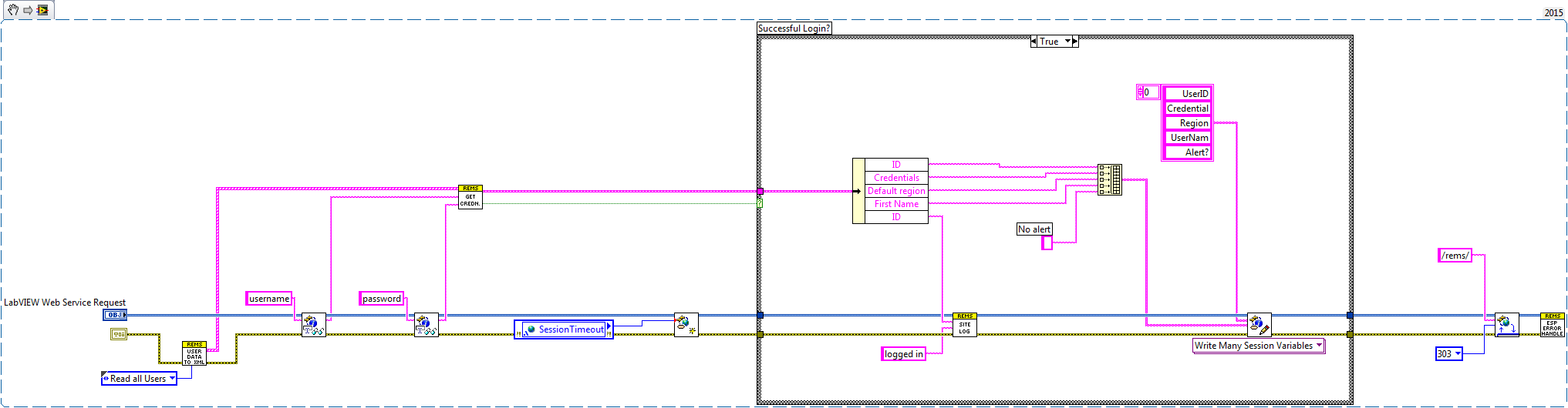

The rems_login.vi received data from the html script show above with the POST method. The login VI had the follwings inside:
If you load these snippets into labview you will have some missing VIs, but the idea as I have processed the data coming from my main HTML page is pretty clear. No matter what, at the end I redirect (303) to my main page after this VI finished running, but if the username / pw matches with the database entry then I put the info of the logged in user to the session variables. If not then I just filled the session variables with dummy data.
My main page always read the session variables and form the html page according to the actual credentials.
