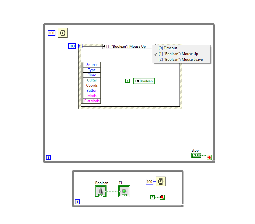

Thanks everyone for answering. I just solved the problem.  Just to be more clear, it's correct that the code will be run on a cRIO real time hardware but it will upload as "run as startup" and a monitor and mouse will be connected to the cRIO to have the possibility to interact with code in real time. The solution that i found is very simple and faced my problem perfectly. I configured the mechanical action of the boolean control as default (switch when pressed) so by using an event structure i cautch the moment the mouse will be up or leave the control, in this way via a local variable and a boolean constant, I forced the signal to go down. Following there is a capture of the code used.
Thanks all for the help and support.
CodeCode.
Pictures are not code and whatever you show here seems a bit silly. 😮
Why would you need a second loop and why do you have a wait and a timeout in the upper loop? Wouldn't it be sufficient to have a mouse-down event and eliminate the lower loop entirely? Why does the upper loop have a stop butting while the lower loop cannot be stopped? Why isn't there an event for the stop?
