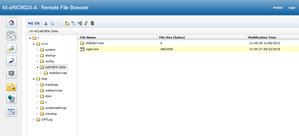

Can I upload an applicatioin to the Real Time system and run it?
Hi, I'd like to take advantage of some tools in the real time system.

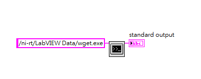

I thought I could upload it by file-transfer,
and then did something like this in the real time system.
No doubt it is failed...
Nonetheless, is there other ways to realize my thought in the real time system?

Was the EXE compiled to run on an ARM?  I'm guessing no which might be one of your problems.  I know NI had some kind of package repo but honestly I haven't even used this hardware yet (but would love to).  But with the new cRIOs running Linux you can use the system exec on the RT target to run applications.  You can also use the call library node somehow but not on DLLs that's a Windows thing.

Yes, I've read the article that System Exec.vi can be used in RT Linux system, but what about not that kind of real time system?
In fact, all I know the system in my CompactRIO is real time sytem, I do not know how to distinguish Linux-based or not.
However, I can not use System Exec.vi, so mine is probably not Linux-based real time system.
How can I do the function such as System Exec.vi in this kind of system?
I'm not sure what you mean "but no on DLLs", if I use the Call Library Node, What should I call??

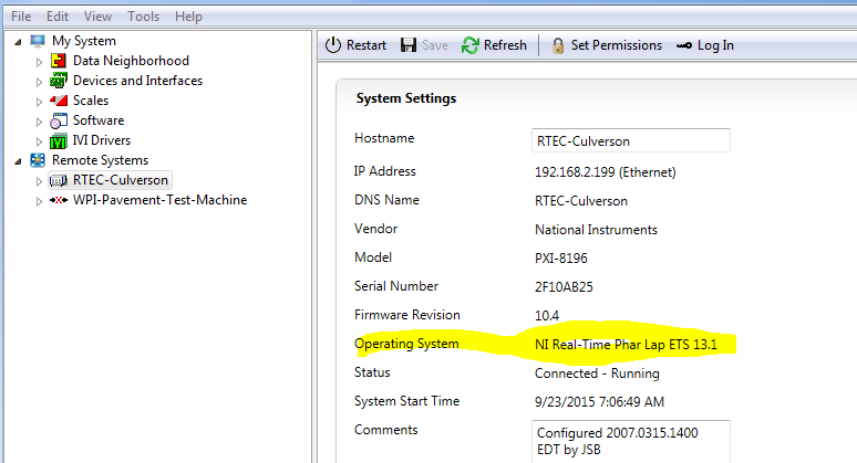

Run MAX on your host, and select the target.  Look in the SYSTEM SETTINGS area for OPERATING SYSTEM. RTOS.PNG

Thank you for the direction:)
Now I know how to determine the OS system~~~
