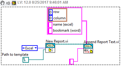

Yes, you can export data to specific cells if you have the Report Generation Toolkit installed.  RGT is not necessary but, in that case, you will need a strong will, lots of Mountain Dew or coffee and a good knowledge of ActiveX.  I think there are other toolkits (not NI toolkits) that can accomplish this as well but I am not familiar with them.
Here is how to do it with RGT:
aputman

Thanks. Currently don't have access to that toolkit, but we may be upgrading soon so I'll wait and see what happens before going too crazy on it.
