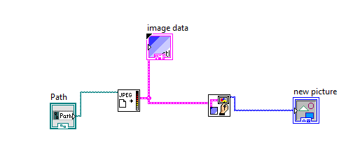

hi dear,
i have tried to do it but i did't get the idea. i ve done the picture programming as shown in the picture attatched. But i am still wondering how am i going to make it appear and disappear
(3,120 Views)
Accepted by topic author Besho
Try the attached.   The visibility of the picture will be toggled by the boolean.   Not sure exactly what you're trying to do, but you should be able to adapt the use of the property node to do what you need.
(3,109 Views)
Thanks you very much, i got what i want :Smiley Wink
(3,103 Views)
