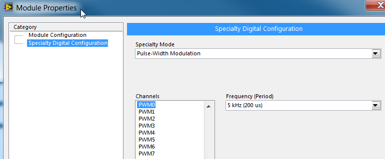

So I saw you were still having trouble in the other thread - from looking at your code, I really can't see why you would be having any issues with outputting a PWM signal by toggling the output on one of the 9474 outputs.
However did you know that, when in Scan Engine mode, you can right click on the C Series module in your project, and there is a tab called 'specialty digital configuration' and it actually allows you to configure the outputs as a PWM signal directly? You specify the frequency, and can then vary the duty cycle:

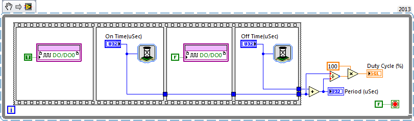

For PWM on FPGA, I usually do something similar to this:
Note that the floating point operations at the end are fairly resource intensive / slow (i.e. multiple clock cycles) - it's only really there to help you see the values. This method allows you to specify both the period and duty cycle (whereas your original code only allows you to set the frequency with a 50% duty period). I don't claim for it to be the most efficient/fastest way to implement PWM either - but it should be no problem for 2kHz PWM.
e.g. specifying an on time of 10uSec and an off time of 90uSec gives you a duty cycle of 10% and a frequency of 10kHz (1/100uS)

Thanks Sam. Does that facility allow you to control the frequency in code?
I am controlling a motor so frequency controls speed and I need variable speed.
Message 16 of 17
(1,732 Views)
Typically with PWM, you keep a fixed frequency and change the duty cycle - the options are configured on the module properties and it's Scan Engine so it might not be possible to change the configuration in real-time and it's only got a fixed number of options.
I'm not really a fan of the Scan Engine so rarely use it - go for the FPGA route I showed above and you shouldn't have any troubles - that will allow you to change the frequency and duty cycle.
