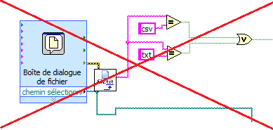

I found a function to determine the file extension, but this solution is not effective because I have to write all possible extentions so that it can read it.
This is why I want to ask if there is another method to distinguish the binary file and the text file in labview?
Thank you.
