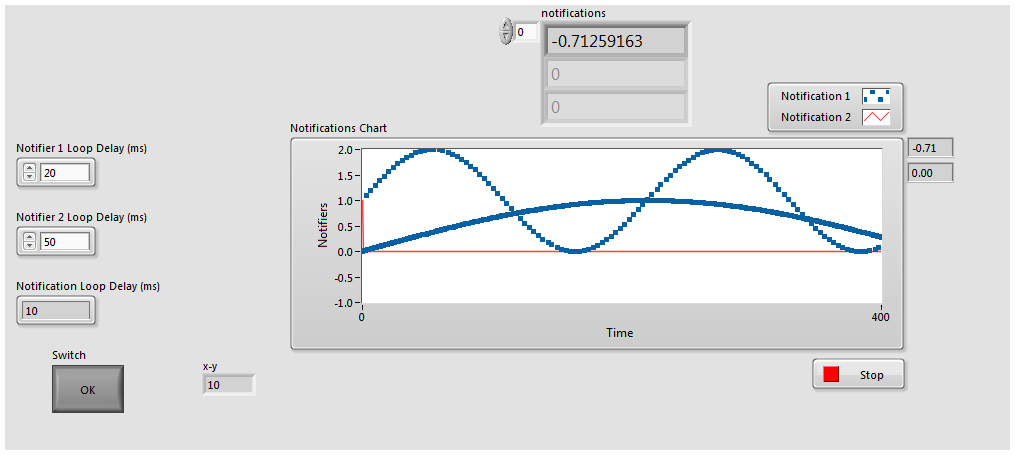

So I was editing the LabVIEW 2013 example to try to understand its behavior but then I came across this weird behavior that I cannot understand.
If you run the attached VI, everything seems to work as expected and you can see Notification Loop updating with values from
Notifier Loop 1 and Notifier Loop 2. However, when you press the "switch" button and change the wait time of the Notification Loop, things start acting weird.
1.First the value of Notifier Loop 2 never updates any more. I thought this had to with aliasing but changing the values of Notifier 2 Loop delay doesn't change anything unless its value is less than Notifier 1 Loop Delay.
2.More importantly, now the values from Notifier Loop 2 is appearing in Notifier Loop 1.
 I inserted an increment function in Notifier 2 Loop so that the sine graph would have an offset be easier to differentiate.
Now Notifier 1 is a sine wave that has a bit of offset instead of Notifier 2.
Whats going on?

I have no real experience with the wait on multiple primitive, but looking at the the help I see that the notification output is defined as "an array of the last messages the notifiers receive...". My understanding is that this means that the primitive looks at all the notifiers and only outputs values for those notifiers which have a new value. Because you're reading faster than you're writing, you always get only one value (which is why the second one is flat) and that value is the value of the last notifier which was updated, which is why it jumps like that.
This becomes a bit more clear if you cancel the interpolation on the first plot:

Thanks for your response.
Changing the interpolation does indeed make things clear. Two graphs are combined into one channel!
That kinda explains why the notification 2 graph is completely flat.. but it still doesn't explain why this is happening.
Another thought, even though I am reading faster than I am writing, the notification 2 is still getting updated, just at a slower rate.
So there should be atleast an intermitten update of notification 2 as well right?
This is so weird..

I am talking about how Notification 1 graph is representing both Notifications. Two sets of notifiers should be coming out separately but it doesnt.
You can check the array size and see that the array size of the notifications changes from 2 to 1 when Notification Loop runs faster.  I have attached another modified VI to explain this.

That's exactly my point. There is an infinite timeout on the W4MN and I have False attached to "ignore previous" which means that every notification should pass along the data. Now that I know for a weird reason both notifiers data are combined into one graph, I can see that Notifier Loop 2 is indeed updating the values correctly. The only problem is that It is being updated as the wrong notifier
