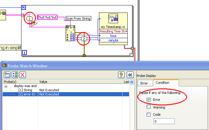

Draw an error out wire on your Scan From String function. Place two probes as shown. On your error out probe select the error pause condition. This should stop it on the input string that causes the error so you can be sure what that string is.

Also, if you stop your VI once the VI pauses on the error probe due to the conditional break.  You should be able to right click on the input string wire going into it and pick Create Constant.  Now that constant will contain the actual data so that when you attach your simplified VI, we can have something to work with.  (In case the problem is some non-printing character that is corrupting your conversion.)

I had tried the probe to source for the error. When the program is paused, showing that error had been found, I tried to stop the program and create constant fromt he input string, unfortunately it shows blank. So what should I do?

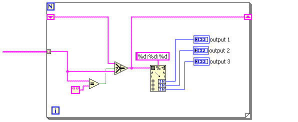

Was probe 8 blank too? It sounds like it might be an empty string that is causing the error.
OK, so this is just a bandaid to keep you running while you work on the rest of your program. If it's a blank string that is causing your problems, add a shift register on your For loop and some logic so that if you get an empty string it will use a valid input that was previously stored on the shift regsiter. Keep in mind that unless you initialize that shift register with something, it will error if the first value in is not compatible with your format string.
If this fixes your problem, put a big comment on this part of your code to remind you to come back and investigate why you sometimes have inputs to this function that are not valid.
