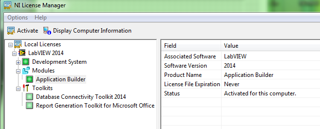

I've an student version of LabVIEW 2014. I've checked and I've got the Application Builder licese activated
But when I go to my project and right click on "Build Specifications"->"New",  I don't have the "Application" option, just the "Source Distribution". Everywhere I see says I've to do this, but I can't find it.
I fear this is a stupid checkbox thing or something I'm not seeing, so if anyone could help me I'd be very gratefull 🙂

Dennis_Knutson escribió:
The student version does not come with the application builder and as far as I know, you cannot add it. You would need to purchase the professional version of LabVIEW. Expand the Development System so we can see what you actually have.
But here says the student version is the same as the LabVIEW Full Development System (but with a watermark). Also, as I have shown in the first post, I have activated an Application Builder license 😕
Sebb
Message 7 of 11
(7,884 Views)

Yes, it is not clear at all why your license manager shows the application builder.
It seems you have a partial version that allows you to built source distributions, but nothing else. I have never heard of such a thing.
Maybe somebody from NI can clarify what's going on.
What does the license manager say about the LabVIEW development system if you expand that section?
