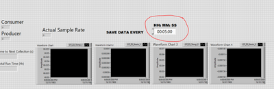

I've modified your code a little bit. Give it a try and let us know. (See attached code).
On your front panel, make sure you change save data every 5 minutes as shown below (the circled control) because you want collect a data point every 5 minutes. You can change it to whatever time you would like.

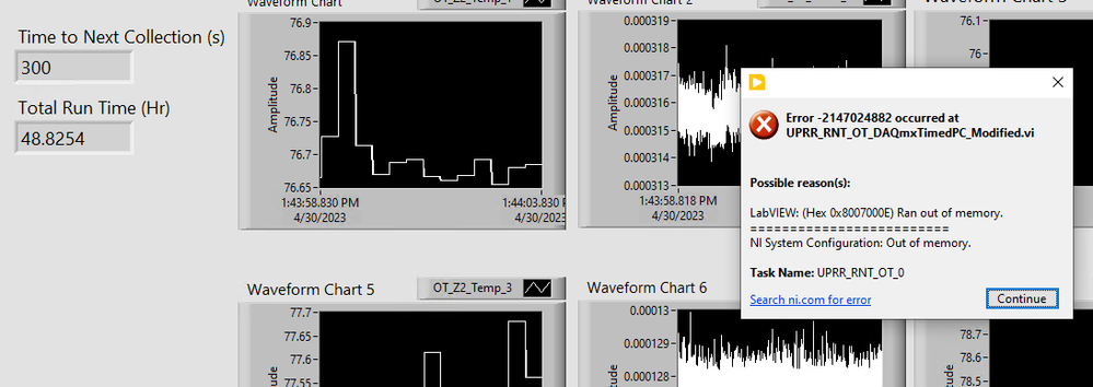

Thank you for the modifications...
Code ran well for 48hrs until the system ran out of memory... so not sure if it still if using too much buffer or other memory? I've tried removing the graphs per the recommendation given here also and see if that help with the issue.
See error below:

3 major issues I see with the code.
1. The top loop is using a channel wire to control its state.  That is adding a ton of overhead when it should just be a simple Shift Register.
2. The cascading Split 1D Array in the bottom loop can be replaced with a single Index Array.  That will eliminate several additional arrays being created.
3. You are constantly adding to your queue, but only occasionally taking data off of the queue.  This is causing multiple issues.  a) The queue is ever increasing in memory usage (the main issue you noticed) and b) you are dequeuing old data.  You should move your timing to the producer loop so that it only enqueues the data every X amount of time.  The consumer can then be a very simple loop where it just has the dequeue and the processing.
I implemented the first two for you.  I don't have the time to fix #3 for you.
