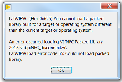

I've had a google about this issue but unfortunately I can't quite find anything that matches it. Last week my laptop crashed and our IT support team had to completely reinstall Windows. I've just about got all of my old programs and addons reinstalled now but I'm having one issue using a packed library that I built prior to the crash.
When I try to add a subVI from the packed library to a new block diagram, I get the following error:
All VIs that use this packed library all load with broken wires now as well. It's weird because I built the library using Windows 7 and that's the operating system that I just had reinstalled. Any ideas?

Hi Dan,
did you by any chance change the bitness of LabVIEW (32bit vs. 64 bit) while setting up your computer again?

Hi GerdW and mtrejos,
Thank you both for your replies. I think the issue could be that when I reinstalled LabVIEW it was the 32-bit version instead of 64-bit. I'll reinstall using the 64-bit version and let you know whether it works.

Hi GerdW,
I doubled checked and my version of LabVIEW is definitely 64-bit. Do you know what else could be causing this issue?

It turns out that actually I did change the bitness. I when I reinstalled Windows I downloaded LabVIEW 64-bit, assuming I was previously using the 64-bit version. In reality I was actually using the 32-bit version previously, I just didn't realise. I've reinstalled and everything is working now. Thanks very much for your help!
