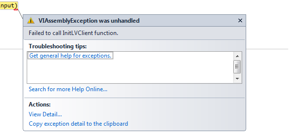

I believe this is exactly as in the example link above and it gives the error message, also above.  For good measure I changed the declaration to:
Private Declare Sub DLLtest_Strings Lib "DLLtest_Strings.dll" (ByRef StringIn As String, ByRef StringOut As String, ByVal StrLen As Long)
and that didn't change anything:  I still got the same error.

Hey Casey,
I tried what you are doing on my end and I see the same errors when calling strings.  I think the issue is with the calling convenction being used by your Visual Basic .NET 2010 code.  I think you may need to use the DLLImport command instead of the Declare command.  Some information on that can be found here:http://msdn.microsoft.com/en-us/library/aa984739(v=VS.71).aspx and here:http://www.devx.com/DevX/Article/6990/0/page/3.  I have not been able to get it working yet using this method but I am going to keep working on it.  Our documentation on this definitely needs to be updated for .NET so that is something I will work on as well.  Please post back with any additional information or questions.

Hey Casey,
I was able to get this working in Visual Basic .NET 2010 if you use the C calling convention when compiling the DLL in LabVIEW if you use the following code:
I am not entirely sure why the standard calling convention is not working but we are going to continue taking a look at it and update our documentation. Please post back with any additional questions.
