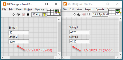

Try typing into the 2 strings on the attached VI.  What happens?
