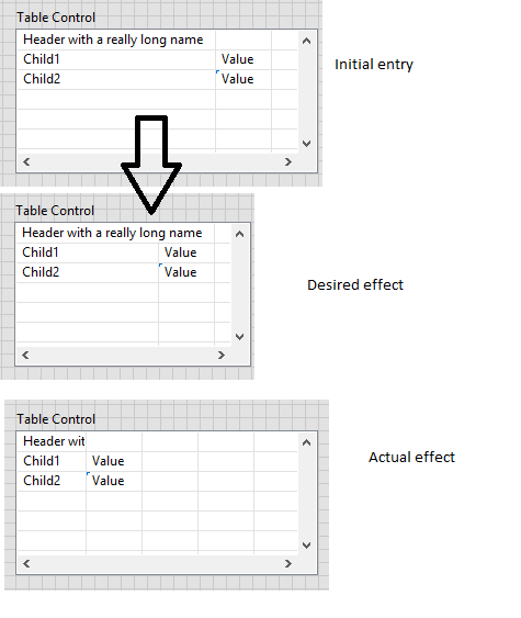

I need either a Table or Tree control where some strings are fairly long (used as subsection headers, one per row) and some are fairly short (used as Name/Value pairs, two items per row). Right now I have to have my columns set to be the max width of the "parent" item, even if that's the only thing in that row, otherwise you can't read the entire Parent item. I can't find a setting or property that lets me do this. Is it possible? Example with Tables shown below, but you get the same behavior with a Tree.

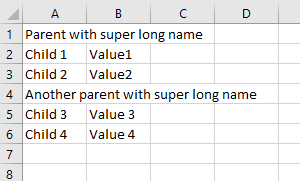

As another example, this is the default behavior in Excel, and I'm trying to reproduce it or something similar using Tree and/or Tables.

As far as I know, the LabVIEW controls (table, multicolumn listbox) do not support this feature.
Since the HTML- tables support merged cells, you could use a browser object via ActiveX to display a self- created html- table.
Greets, Dave

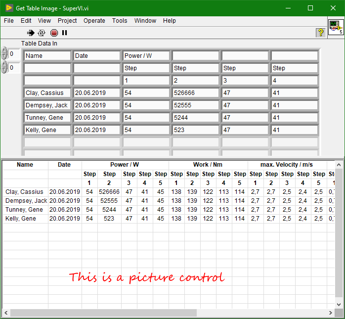

So, as I wrote it down in my former post, it came into my mind, that I myself could need this for an old project to beautify the data presentation. So I tried this and want to post my solution (it is not very general but perhaps a good start for other requirements). It was great fun to program this Smiley Wink
Greets, Dave
