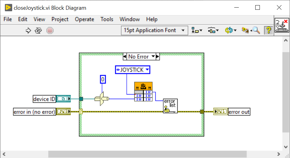

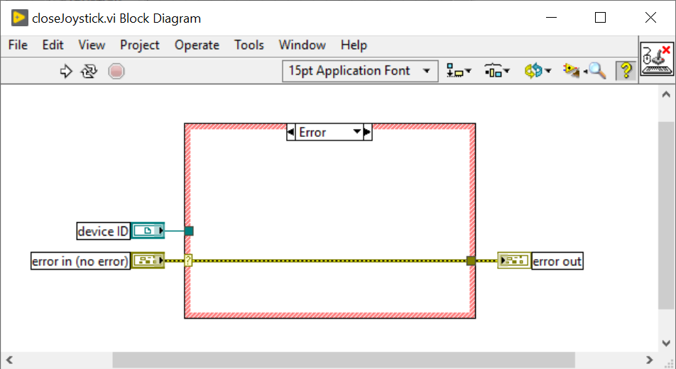

So, it looks like "Close Input Device" is written such that it doesn't actually do anything in the error case:
Could you try NOT wiring the error wire in to the close function (or clearing the error first)?
I would test it myself, but I don't have a joystick handy.
Message 5 of 12
