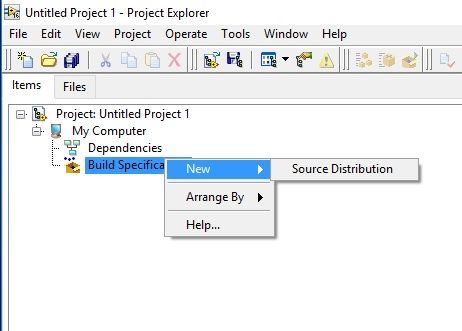

Hi everyone, I am trying to make .exe file with my project but I am unable to do it. I have a professional version of LabView, do you know what am I doing wrong? I watched youtube tutorials, but my labview is not as theirs.

Do you have the application builder installed?

Try reinstalling LabVIEW or verify application builder license is activated correctly.

Did you activate for the Professional version?  This can be checked easily with the NI License Manager.

Application Builder wasnt activated. Thanks guys!
