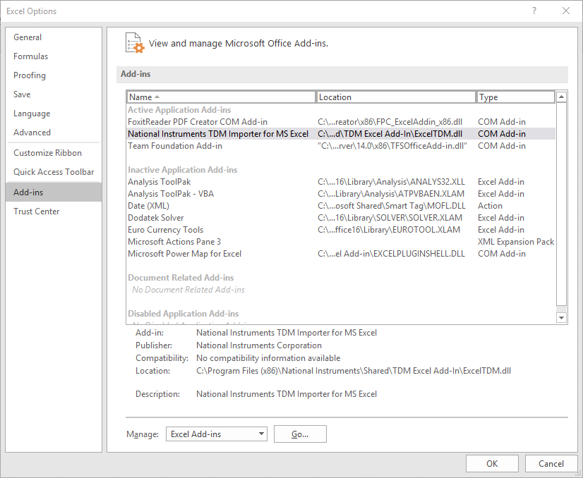

Try to check in Options, whether Excel 'sees' the Add-in. Open Excel and go to File -> Options -> Add-ins, I can see it like that:
If Excel doesn't see it you can browse manually the add-in. Click the Go... button (bottom of the window) and find ExcelTDM.dll file (you can see path on the screen I have shown).
Let us know if that helped!

If I tryed to open a TDMS file with right click on it and I choose open with TDM importer. I see that the program tries to open the file but immediatly aborts this process without error message.
@mtwr: You can check my first post, first attachement. The Add-In is listed as inactive. When I try to activate it, excel tells me that there was a runtime error and it couldnt be loaded.
